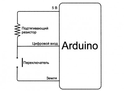

    In this example, we assumed that a digital input can only have one of two values: HIGH or LOW. If you use a switch connected to the digital input, it usually only allows you to close the circuit. In most cases, connecting the digital input to ground (0V) is necessary. If the switch's connection is open, it's called the digital input being "unconnected" or "floating." In simpler terms, it lacks an electrical connection, making it susceptible to electrical interference and frequent transitioning between high and low states spontaneously. To avoid this undesired behavior, a "pull-up resistor" is frequently used, as depicted in the diagram.
    When the switch is open (as shown in the diagram), the resistor pulls up the input pin to a 5V voltage. However, when we press the button and close the switch, the connection to ground from the switch supersedes the weak input pull-up.
    You can opt to use separate external pull-up resistors, but Arduino inputs have built-in pull-up resistors with an approximate value of 40k ohms. Activate the built-in pull-up resistors by setting the pin's operational mode to INPUT_PULLUP, instead of INPUT alone. The code below illustrates how to configure a digital input pin to operate with a switch, eliminating the necessity for an external pull-up resistor as illustrated in the
    diagram:
    pinMode(switchPin, INPUT_PULLUP);

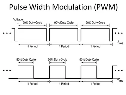

  • Analog Outputs
    On an Arduino Uno, the digital pins are capable of only toggling electronic components, like LEDs, on and off.
    However, if you need to finely adjust the voltage being delivered to a device, you'll require an analog output. This type of output is particularly handy for controlling the brightness of an LED or the speed of a motor.
    It's important to note that not all pins on the Arduino Uno support analog output functionality. Only pins D3, D5, D6, D9, D10, and D11 can serve this purpose. These pins on the Arduino board are identified with a tilde symbol (~).
    To regulate the analog output, you can utilize the analogWrite() function, which accepts parameters ranging from 0 to 255. A value of 0 signifies 0 V (completely inactive), while 255 represents full power.
    One might assume that the analog pin accepts a voltage within the 0 V to 5 V range. If you were to connect a voltmeter between the analog pin and ground, and then adjust the analogWrite() parameters from 0 to 255, it might seem like the voltage is smoothly changing between 0 and 5 V. However, the reality is more intricate. This phenomenon is known as Pulse Width Modulation (PWM), as illustrated in the figure.
    Each pin operating in analog output mode generates 490 pulses per second, with the exception of pins D5 and D6, which produce 980 pulses per second. You can alter the duration of these pulses by adjusting the parameters of the analogWrite() function. Essentially, the longer the pulse remains high, the more power is delivered to the output. Consequently, the LED will shine brighter or the motor will spin faster.
    Viewed 34878 times
    The voltmeter records this process as a change in voltage because it is not capable of reacting swiftly enough. As a result, it effectively averages the received voltage, creating the impression of a gradual change to us.
