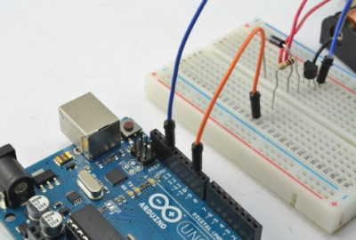

    Connecting Arduino
    Connect the prototype board to Arduino as shown in the figure below: connect the ground from the prototype board to the GND socket and the control output from the prototype board to the D9 socket.
    Connecting breadboard to Arduino
    Connecting breadboard to Arduino Viewed 26449 times

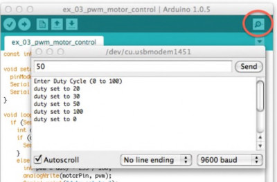

    Upload the program to Arduino. On the computer where you're programming Arduino, open the Serial Monitor in Arduino IDE. To do this, click on the magnifying glass icon in the upper right corner of the Arduino IDE window (circled in the image below).
    Next, you'll be prompted to enter a duty cycle value from 0 to 100. Try entering different values and see how it affects the speed of the DC motor. When you decide to stop the motor, simply set the duty cycle to zero.
    Note: If you go down to values like 10-20, the motor may not rotate but emit a buzzing sound since there won't be enough energy to overcome friction and initiate rotation.

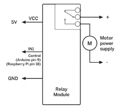

    The experiment setup is illustrated in the diagram below. The relay contacts act as switches, each of which can be in one of two positions. As mentioned earlier, there are common, normally open (NO), and normally closed (NC) contacts. When the relay coil is not energized, the common contact is connected to the normally closed contact. When power is supplied to the coil, the switch's position changes, and the common contact connects to the normally open contact.
    Circuit for controlling a DC motor with a relay module
    Circuit for controlling a DC motor with a relay module Viewed 26447 times

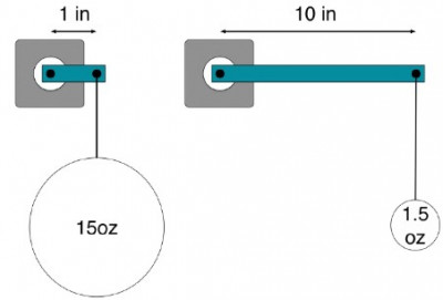

    In simple terms, torque refers to the rotational force of a motor. The greater the torque of a motor, the more force it can exert to rotate its shaft (rotor).
    From a scientific perspective, torque is defined as the force multiplied by the distance, where the force is measured in newtons (N), and the distance is measured in meters (m). In a more practical context, the force component of torque is often expressed as the force required to lift a specific weight in kilograms (or ounces) over a distance measured in centimeters (or inches).
    Distance is included in the equation because, as the distance from the rotor's axis increases, the motor can apply less and less force to the load. For example, if the torque of a motor is stated as 1 kgf/cm (kilogram-force per centimeter), it means that at a distance of 1 cm from the rotor's axis, the motor can hold a weight of 1 kg, i.e., it won't be able to handle a more substantial weight. However, at a distance of 10 centimeters from the rotor's axis, it can only hold a weight of 100 grams (10 cm x 100 g = 1 kgf/cm). The relationship between weight and distance from the motor's axis is illustrated in the figure below:

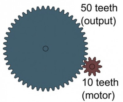

    Gear Reduction
    Although you can slow down the motor's speed effectively using pulse-width modulation (PWM), reducing the energy supplied to the motor also reduces the generated torque. Gear reduction is a way to slow down the rotation of motors while increasing the torque as a side effect. For example, if you use a 5:1 gearbox (as shown below) with 50 teeth on one gear and 10 teeth on the other, for every five rotations of the motor, only one rotation is transferred from the gearbox. However, the torque at the output of the gearbox will be ten times stronger than what you would get directly from the motor.

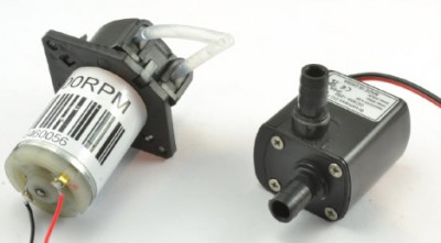

    Enthusiasts often use two common types of pumps: hose pumps or dynamic pumps.
    Hose pump (left) and dynamic pump (right)
    Hose pump (left) and dynamic pump (right) Viewed 26447 times
    Both types of pumps are driven by direct current motors, but their properties differ significantly. If you require a slow, steady flow, opt for a hose pump, while a dynamic pump is suitable for rapid and turbulent flows.
    Hose Pumps
    Hose pumps are designed for very controlled liquid transfer. They are frequently used in medicine and research to pump precisely defined volumes of liquid. For more precise flow control, hose motors are sometimes controlled by stepper motors.

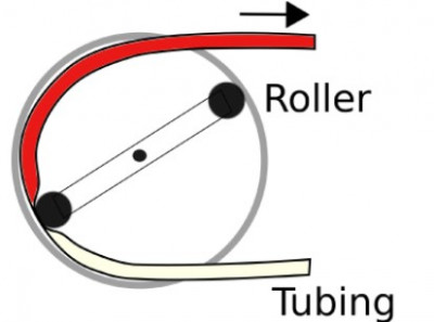

    The principle of a hose pump is illustrated in the figure below. The pump consists of a motor and a gearbox that rotates a shaft with rollers, compressing a flexible tube and pushing liquid through it. Not surprisingly, the tube wears out over time due to continuous compression, so it needs to be replaced. Therefore, the tubes in such pumps are typically replaceable.
    Working principle of the hose pump
    Working principle of the hose pump Viewed 26447 times
    By supplying energy to the gearbox of a hose pump using PWM and an H-bridge, you can control not only the speed but also the direction of the liquid flow.
    Hose pumps are self-priming, meaning that if they are positioned slightly above the liquid level, they generate enough suction to draw in some liquid and start pumping it.

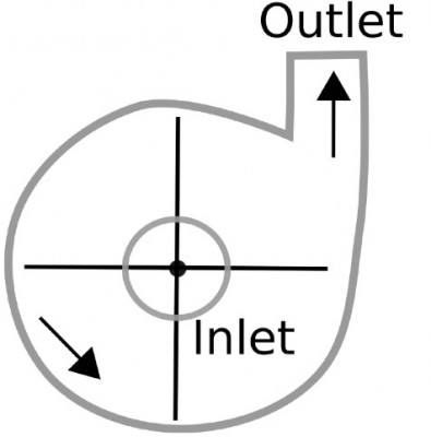

    If you aim to quickly transfer a large volume of liquid, you will need a dynamic pump. There are many types of dynamic pumps, but one of the most common is the centrifugal pump.
    Operating principle of the centrifugal dynamic pump
    Operating principle of the centrifugal dynamic pump Viewed 26447 times
    Liquid enters the pump from the front along the motor's axis, where the blades rotate. These blades impart centrifugal force to the incoming liquid, pushing it towards the edge of the pump casing and outward.
    Dynamic pumps are not self-priming, and they require liquid at their inlet before pumping. Unlike hose pumps, dynamic pumps can pass liquid through them even when they are not actively pumping it. Some pumps of this type are designed for garden ponds or aquariums and can be completely submerged underwater. Another difference between dynamic pumps and hose pumps is that dynamic pumps cannot pump liquid in reverse.

    A variety of hose pump used in this project is designed for aquarium use and can be purchased for a very small amount of money.
    The tube I used here came with a watering kit I bought at a hardware store. Along with it, I also acquired small plastic connecting sleeves, which are used to connect sections of the tube together. The connections of the tubes must be sealed, otherwise the pump will not work.

    Step 3. Attach the tube to the pump
    You will need two pieces of tubing. One should submerge into the water container to its full depth, reaching from the pump mounting hole located at the top of the container to the bottom. The second one should run from the pump's outlet hole to the plant you intend to water. The pump and tubes are shown in close-up in the image.
    The input and output of the pump are usually not marked, but hose pumps can move liquid in both directions. Therefore, if you notice that the pump is sucking in water instead of pumping it, it is better to resolder the mounting wires on the motor rather than rearranging the tubes.
    I decided that it would be convenient to insert the pump into the water container from the top and glue the motor to the pump. The input tube then goes straight into the container, while the output tube protrudes from the side and is directed towards the plant. To insert the pump, I had to trim the neck of the milk bottle I used a bit.
    The image shows the design I ended up with, but you can certainly install the pump at the bottom, next to the breadboard. However, in that case, you will need a longer tube.
