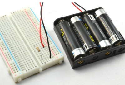

    To conduct the experiment, simply connect the resistor to the terminals of the battery power source. The breadboard is only needed to secure the position of the resistor, as shown in the diagram below.
    However, do not connect the battery yet, as the resistor will immediately start heating up.

    Connect the battery, and with the help of a thermometer, observe how quickly the resistor heats up. The temperature of the resistor can reach up to 75°C. Be cautious - this is hot enough to burn your finger!
    The resistance of the 100-ohm resistor and the circuit's voltage of 6V allow you to calculate the current using the formula:
    I = V / R = 6 / 100 = 0.06 A
    The power dissipated across the resistor is equal to the current multiplied by the voltage:
    6 x 0.06 = 0.36 watts or 360 milliwatts (mW). This is slightly higher than the power the resistor can safely dissipate for extended periods (250 mW). Therefore, if operated in this mode for an extended period, it may quickly fail.

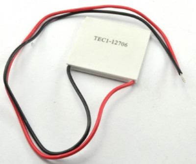

  • Peltier Elements (see figure below) possess a highly useful property where passing current through them causes one side of the element to become hotter while the other side becomes colder.
    To make this happen, the current flowing through it needs to be substantial (typically between 2 to 6 A at 12 V), meaning you'll require a sufficiently powerful power supply to use a Peltier element. These elements are often found in portable refrigerators and beverage coolers. In some cases, Peltier elements are preferred over conventional refrigeration systems because they lack moving parts that can break.
    How Peltier Elements Work
    When an electric current passes through the junction between two different conducting materials, one side of the junction becomes slightly hotter, while the other becomes slightly colder. This phenomenon was named the Peltier effect after the French physicist Jean Peltier, who discovered it in 1894. This phenomenon is also known as the thermoelectric effect.

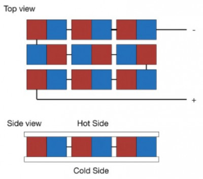

    The thermoelectric effect is relatively small, so to make it useful, such as for cooling beverages, it needs to be greatly amplified. This is achieved by arranging groups of junctions one after another, so when current passes through, each junction contributes to the overall effect. Typical inexpensive Peltier elements have around 12 junctions. On both sides of the Peltier element, there is a base material forming the foundation for the groups of junctions.
    The materials forming the junctions of the Peltier element are semiconductors of two types, similar to those used in the production of transistors and microchips but optimized for the thermoelectric effect. They are known as N-type and P-type semiconductors, with N standing for Negative and P for Positive.
    Peltier element design
    Peltier element design Viewed 23032 times

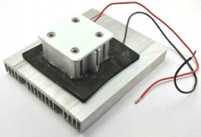

    The main issue with Peltier elements is that their hot and cold sides are in close contact, so the hot side rapidly heats the cold side. To reduce this undesirable effect, heat must be removed from the cold side as quickly as possible.
    A solution to this problem is the use of a heat sink (see figure below). Such a radiator consists of an aluminum plate with fins that increase the surface area for cooling, aiding in better heat dissipation. The cold side of the element is constructed as a block that fits inside the heat sink.
    Peltier element on the heat sink
    Peltier element on the heat sink Viewed 23032 times

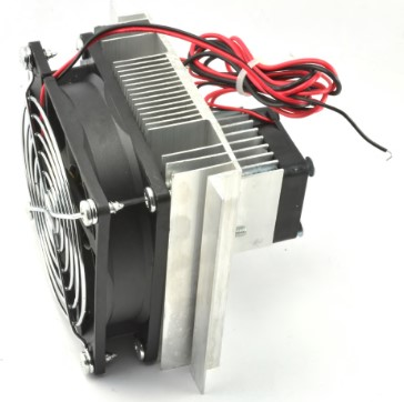

    A simple radiator by itself is not as efficient as one with a fan. The fan carries away the heat from the radiator's plates due to convection and replaces it with fresh cold air. In practice, some devices have fans on both sides of the Peltier element, which enhances its efficiency (see figure below).
    Cooling of the Peltier element by two fans
    Cooling of the Peltier element by two fans Viewed 23032 times
