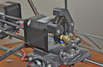

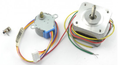

    The image showcases three examples of stepper motors. Miniature motors like the one depicted on the left are used for adjusting lens components in compact cameras or smartphones. In the center, there is a 5V stepper motor with a built-in gearbox, which houses both the stepper motor and the reducer. On the right, you can see a stepper motor typical for printers.
    As implied by their name, stepper motors rotate in a series of short steps. This sets them apart from free-rotating motors. A stepper motor will take as many steps as specified, allowing you to precisely determine how many steps it has taken. This characteristic is one of the reasons why stepper motors are widely used in both conventional and 3D printers. In regular printers, they precisely position paper, while in 3D printers, they control the movement of the print bed and nozzle.

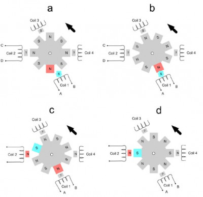

  • The diagram below illustrates the operation of a stepper motor, more specifically, the operation of a bipolar stepper motor. Another type of stepper motor, unipolar stepper motors, will be discussed in the section "Unipolar Stepper Motors" later.
    In a bipolar stepper motor, there are typically four coils. The coils that are positioned opposite each other are connected in such a way that they operate synchronously. All the coils are located on the stationary stator of the motor, eliminating the need for a rotating commutator and brushes as found in DC motors.
    Schematic diagram of bipolar stepper motor operation
    Schematic diagram of bipolar stepper motor operation Viewed 30496 times
    The rotor of a stepper motor is designed as a series of magnetized teeth with alternating north (N) and south (S) poles (there are usually more teeth on the rotor than shown in the diagram). Each coil can be energized to become either a north or a south pole, depending on the current direction through the coil (reminding you of H-bridges, isn't it?). Coils 1 and 3 work together so that when coil 1 becomes a south pole, coil 3 also becomes a south pole. The same applies to coils 2 and 4.
    Let's start with figure a: when coil 1 (and consequently, coil 3) are energized to become south poles (S), the rotor rotates counterclockwise until the nearest rotor teeth with a north pole (N) magnetization align with coils 1 and 3 (as shown in figure b). To continue rotating counterclockwise, on the next step (figure c), current needs to be applied to coils 2 and 4 to make them north poles (N). Then, the nearest rotor teeth with south pole (S) magnetization will be attracted to coils 2 and 4 (figure d).
    Each of these actions rotates the motor's rotor by one step. To continue rotating counterclockwise, coil 1 needs to be magnetized as north (N) again, as shown in the table.

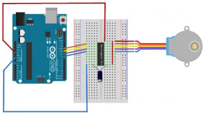

    Stepper motor control circuit from Arduino assembly
    Stepper motor control circuit from Arduino assembly Viewed 30496 times
    Connecting Arduino
    When connecting Arduino to the L293D microchip, the following pins are used.
    Contacts for connecting Arduino to L293D chip
    Contacts for connecting Arduino to L293D chip Viewed 30496 times
    The layout of the prototype board for the Arduino version is shown in the figure below. Ensure that the microchip is correctly installed (the notch on the chip's housing should be facing upwards), and that the 100µF capacitor C2's positive terminal is connected to pin 8 of the L293D. To make it easier for you to orient, remember that the positive lead of an electrolytic capacitor is usually longer than the negative one. The negative terminal of the capacitor can also be marked on its body with a "-" symbol or a diamond.
    Layout of breadboard for controlling bipolar stepper motor with Arduino
    Layout of breadboard for controlling bipolar stepper motor with Arduino Viewed 30496 times

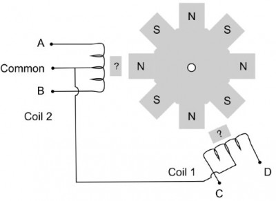

  • Unipolar stepper motors operate almost the same way as bipolar motors but do not require H-bridges for control. This is due to their more complex coil structure. The diagram below illustrates the operation of a unipolar stepper motor.
    A unipolar motor has five coil leads, unlike the four leads of a bipolar motor. Four of these leads are equivalent to the leads of a bipolar motor, representing the coil ends A, B, C, and D. So, if desired, you can use the ends of coils A, B, C, and D and control them with H-bridges as if it were a bipolar motor, and everything will work fine.
    Unipolar stepper motor operation diagram
    Unipolar stepper motor operation diagram Viewed 30496 times
    The fifth lead of a unipolar stepper motor connects to the midpoints of each coil's windings. By connecting this lead to the ground (GND), you can magnetize the coil's north pole when supplying power to lead A, or the south pole when supplying power to lead B. This eliminates the need for H-bridges.

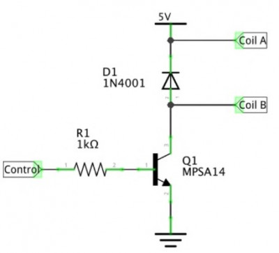

  • The absence of a need for H-bridges to control unipolar stepper motors does not negate the fact that the motor coils consume too much current to be powered directly from the outputs of an Arduino or Raspberry Pi.
    An obvious way to increase the current is to use transistors, as demonstrated in the "Experiment: Motor Control" section. You will need four transistors, one for each of the leads A, B, C, and D. Additionally, current-limiting resistors will be required in the base circuit of these transistors, along with protective flyback diodes for each coil. The diagram below illustrates how to connect each coil of a unipolar motor, and you will need four such circuits for complete motor control.
    Power key of unipolar stepper motor on one transistor
    Power key of unipolar stepper motor on one transistor Viewed 30495 times
    These circuits can be readily assembled on a prototyping board, but it will require quite a few jumpers.
    A more elegant solution is to use a specialized integrated circuit (IC), such as the ULN2803. This affordable IC contains eight individual Darlington transistor pairs in a single package. Moreover, it already includes base resistors and protective diodes. The only additional component required would be a capacitor in the power supply circuit.
    The ULN2803 IC (www.adafruit.com/datasheets/ULN2803A.pdf) can handle currents up to 500 mA in each channel at a maximum voltage of 50 V.

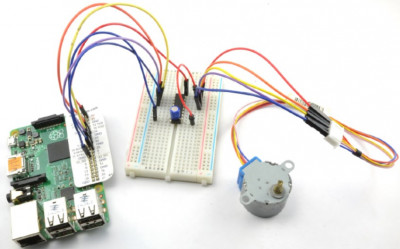

  • The image below illustrates a Raspberry Pi board controlling a unipolar stepper motor of one of its widely used types, equipped with a 1:16 reduction gearbox. Although the motor itself takes 32 steps per revolution, the presence of the reducer means that 513 phase transitions must be executed for one full revolution, equivalent to 128 steps per revolution.
    Unipolar stepper motor control circuit assembly
    Unipolar stepper motor control circuit assembly Viewed 30495 times

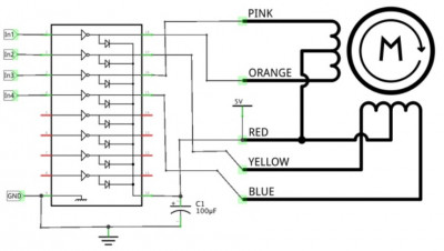

    The diagram below shows the connection scheme of unipolar motor coils modified for use with the ULN2003 microchip. Note that there are still four unused composite transistors that can be used to control a second stepper motor. For stepper motors with higher operating currents, the transistors of the microchip can be paired by connecting two of their inputs and two corresponding outputs together.
    In this setup, a low-power motor with a 5 V power supply and a relatively low working current is used, making it possible to power it directly from a Raspberry Pi or Arduino. With two coils energized, the current consumption is approximately 150 mA. If a more powerful motor or one with a higher supply voltage is used, a separate power source will need to be connected, as was done with the bipolar stepper motor.
    Finding out which lead is connected to what inside the motor can be done in the same way as recommended for the bipolar motor. Additional complexity here arises from the presence of a common wire. Therefore, you should start by finding the common wire that resists rotation while being connected to any of the other leads. Then, to find the other wires, you can use the same method as for the bipolar motor.
    Unipolar stepper motor control circuit (wire colors of the real circuit may differ from those shown here)
    Unipolar stepper motor control circuit (wire colors of the real circuit may differ from those shown here) Viewed 30495 times

    IC1 - ULN2803 Microchip
    C2 - 16V 100uF Capacitor
    M1 - 5V Unipolar Stepper Motor
    4xAA Battery Holder (6V)
    400-Point Breadboard
    Jumper Wires
    Connecting Arduino
    The diagram shows how you can connect an Arduino Uno to the ULN2803 microchip.
    Connecting Arduino to ULN2803 chip
    Connecting Arduino to ULN2803 chip Viewed 30495 times
    You just need to make sure the capacitor is installed correctly, with its longer positive lead oriented to the right. The microchip should be positioned so that the notch on the housing faces the top side of the prototyping board.
    As you can see, the assembly is neater compared to the setup for a bipolar motor.

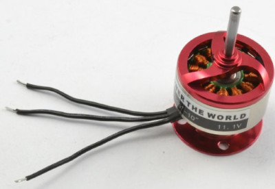

  • Brushless DC motors (BLDC) are small yet powerful motors commonly found in quadcopters and radio-controlled model airplanes. Despite their small size, they can generate much greater torque compared to traditional DC motors of the same weight. They are included in this chapter because they share many similarities with stepper motors, although they are formally categorized as DC motors.
    Collectorless DC motor
    Collectorless DC motor Viewed 30493 times
    Unlike brushed DC motors, brushless DC motors do not have a mechanical commutator-collector that changes the current direction during motor rotation. In terms of construction, they are more similar to stepper motors, with the difference being that instead of two pairs of coils, they contain several sets of three coils. Based on this characteristic, they can be considered more like three-phase electric motors, and the drives for brushless motors are significantly more complex than traditional H-bridges. Indeed, each coil can conduct current in both forward and reverse directions and can also be in a "high-impedance," i.e., disconnected state. To efficiently control the motor, its control microchip (driver) must measure the voltage across the "disconnected" coil to adjust the switching time to the next phase of operation.
    Unfortunately, it is practically impossible to find brushless DC motor control chips that can be easily mounted on a prototype board. Therefore, it is better to look for ready-made driver boards.
    To obtain the power and dimensions of a brushless DC motor without the hassle of control boards, you can purchase a motor with a built-in controller and only two wires coming out of the casing. You can then connect it like a regular DC motor.
