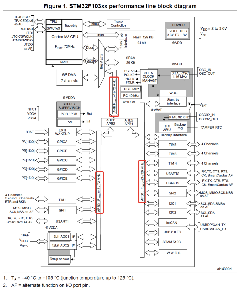

In the datasheet for the STM32F103x8 there is a block diagram that shows which peripherals are connected where:
The diagram in Fig. 1 may seem complicated and incomprehensible at first, this is normal, in time everything will settle in your head and the feeling of incomprehension will disappear.

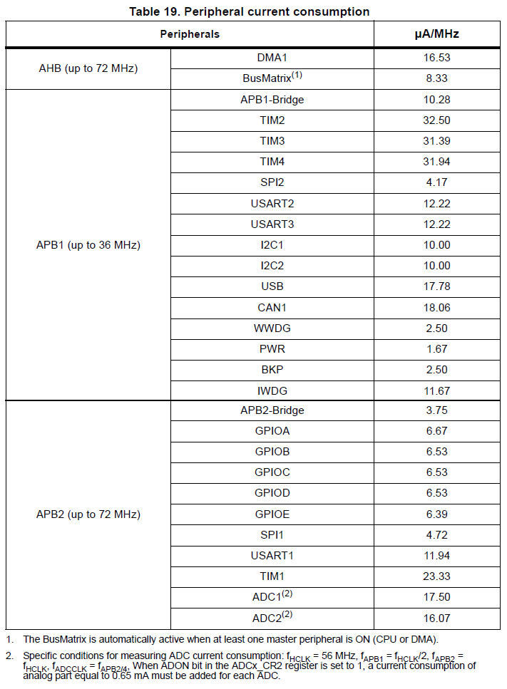

There is also this table, which also shows the peripheral devices and the buses to which they are connected:
It can be seen that in Fig. 2 the bus name (AHB, APB1 and APB2) has its maximum frequency in parentheses. Since the peripheral devices receive the clock signal from the bus, its frequency sets the speed of the devices connected to this bus. Below we will consider how to set the frequency of each of the microcontroller buses.

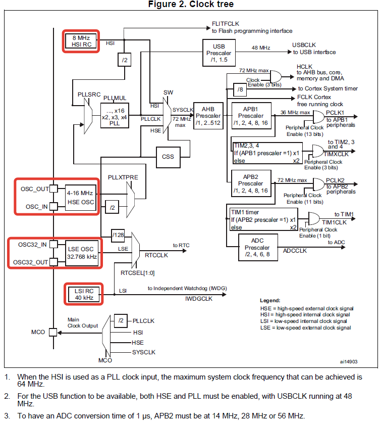

Several clock generators are present in the STM32F103x8/B microcontrollers:
The first of these is an 8 MHz internal RC oscillator called the High-speed internal (HSI) RC oscillator. After reset, the microcontroller is clocked from this oscillator by default. Its main advantage is that no additional external components are needed for the oscillator to work. However, its disadvantage is poor stability of the generated frequency: when the ambient temperature changes, its frequency of 8 MHz will float a bit. This may not be critical for devices not demanding time intervals, but in some cases this feature is unacceptable.
Next is the High-speed external (HSE). This oscillator is an alternative to HSI. It requires an external quartz resonator for 4-16 MHz. Its main advantage in comparison with HSI is the stability of the generated frequency. Also, with some customization, the OSC_IN pin can be connected to a source of a ready rectangular clock signal without using a resonator.
Next is the Low-speed external (LSE). This oscillator also requires an external quartz resonator, but only at 32768 Hz. The LSE is only used to clock the built-in RTC real-time clock, which can be used to clock the current time if needed.
The last oscillator is the low-speed internal (LSI) RC oscillator. This is a 40 kHz internal RC oscillator. It is not very accurate, but it has a very important task: generating a clock signal for the MC watchdog timer, which will restart the system in case of a hang-up. You can also clock the RTC from LSI, but most likely nobody will do this.

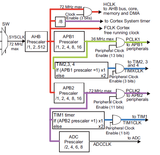

The processor core and most peripherals use the SYSCLK clock signal.
After the AHB Prescaler, the clock signal is distributed among the microcontroller buses. The HCLK signal goes to the processor core, memory and the AHB bus periphery. FCLK also goes to the core. The clocking is fed to the Cortex System timer via a fixed divider by 8. The APB1 Prescaler generates the clocking signal for APB1 bus devices and the APB2 Prescaler for APB2 devices.

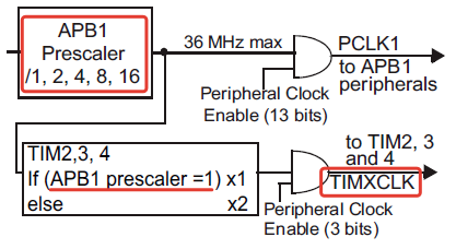

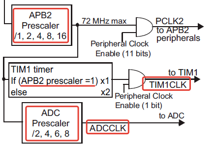

There is a small peculiarity of clock signal generation for timers and ADCs. The clock signal is applied to the timers as follows. If the bus divider (APB1 Prescaler or APB2 Prescaler) is set to one, the clocking frequency of the timers (TIMXCLK or TIM1CLK) will be equal to the bus frequency. But, if the divider is not equal to one, then the clocking frequency of the timers will be 2 times the bus frequency (see Figure 5, 6). This is how the ADC has its own divider, which forms the ADCCLK signal from the APB2 bus clock frequency (Fig. 6).

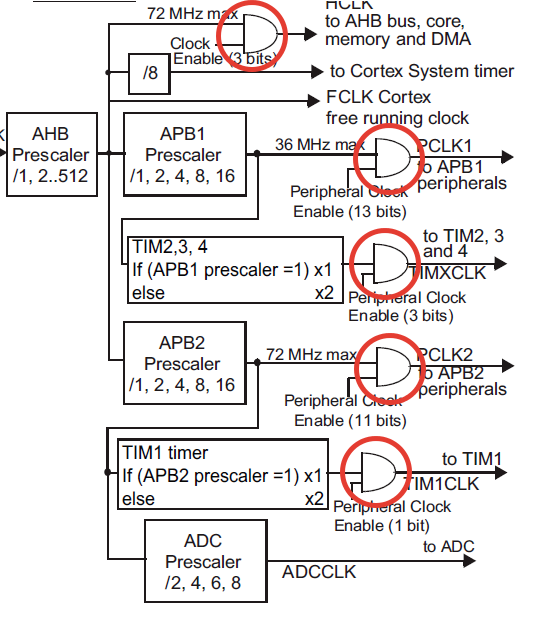

I think we should also pay attention to these elements of the block diagram:

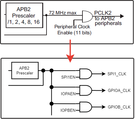

These are nothing but devices for supplying a clock signal to a specific peripheral (2I logic elements). I will try to redraw one of them to make it clearer what it is and how it works:
Each peripheral module has its own bit in a special register (SPI1EN, IOPAEN, IOABEN and so on), which, when set to one, allows the clock signal to be applied to it. In Fig. 8 I have given an example only for the clock signal PCLK2 of the APB2 bus, for the other signals (HCLK, PCLK1, TIMXCLK, TIM1CLK) it is the same.

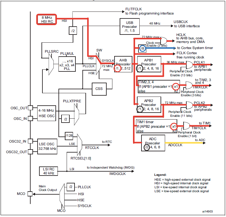

So now we know that the main clock signal in STM32 microcontrollers is SYSCLK. Let's now understand how to get it. We have 3 options at our disposal: HSI, HSE and PLL generators:
After resetting the microcontroller, the built-in RC generator HSI is set as the default source of the SYSCLK signal. The clock signal flow for this case is shown in Fig. 10, the default values of all dividers are circled:
Now let's calculate the values of all frequencies in the default configuration. The frequencies of HCLK, FCLK, PCLK1, TIMXCLK, PCLK2, TIM1CLK will be equal to 8 MHz, the frequency of Cortex System timer is equal to 1 MHz, and ADCCLK is 4 MHz.

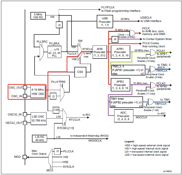

If we want to use the HSE generator, the picture is as follows:
When using an 8 MHz quartz resonator, all system frequencies will be the same as in the previous case. The only difference is that the frequency stability is better when using the HSE oscillator than when using HSI. However, if we want to maximize the performance of the whole system, we need to use a PLL frequency multiplier block as the SYSCLK source.
