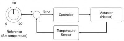

    The illustration shows why such systems are called control loops.
    In the case of a thermostat in a house, a desired temperature is set - let's call it the control or set temperature. The temperature sensor measures the actual temperature. The difference between the actual temperature and the set temperature determines the error. Then the controller receives this error to calculate the power supplied to the heater.
    Control circuit (thermostat example)
    Control circuit (thermostat example) Viewed 21988 times
    In the simplest scenario, the heater is either turned on or off. If the temperature error is positive (meaning the set temperature is higher than the actual temperature), it means the house is cold enough to turn on the heater. Conversely, if the actual temperature rises above the set temperature, it means the house is warm enough to turn off the heater.

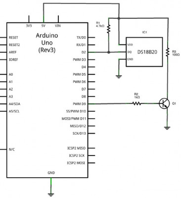

    Circuit Diagram of the Experiment
    The schematic diagram for our experiment is shown in the figure below. It consists of two parts: the DS18B20 temperature sensor, which requires a pull-up resistor R1 with a 4.7k-ohm rating, and the heating section, with transistor Q1 placed at its center. Resistor R2 limits the current flowing into the transistor's base, while resistor R3 serves as the heating element.

    DS18B20 IC
    The DS18B20 IC is a highly useful compact device. Its value lies not only in its accuracy (±0.5 degrees Celsius) but also in its ability to create a chain of similar devices using just one Arduino or Raspberry Pi pin.

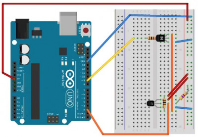

    Breadboard Layout of the Experiment

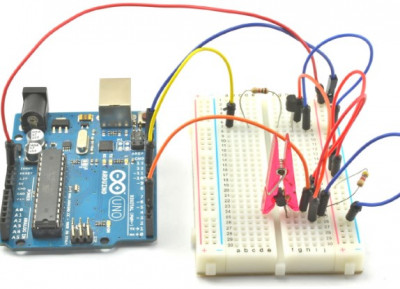

    The circuit assembled on a breadboard for conducting the experiment is shown in the figure below.
    Circuit assembled on breadboard for thermostat based on on/off switch
    Circuit assembled on breadboard for thermostat based on on/off switch Viewed 21988 times

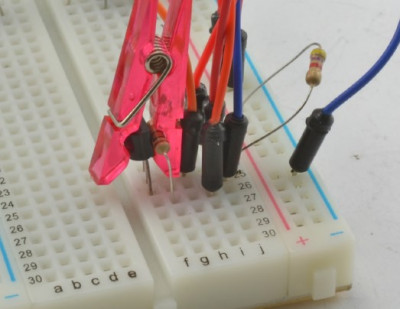

    The heating resistor R3 is placed immediately behind the flat side of the DS18B20 sensor so that they can be firmly pressed together with a small clip.
    Two Arduino pins are involved in the circuit: Pin D9 is used to control the transistor, switching the power to the resistor acting as the heater on and off, while Pin D2 serves as the input for the digital sensor signal.
    Make sure to place the transistor and DS18B20 IC correctly, towards the right edge of the breadboard.
    The resistor and the DS18B20 sensor are held together by a small clothespin
