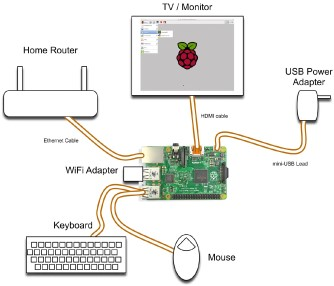

Here's the equipment you'll need for setting up Raspberry Pi:
- A keyboard and mouse with USB connectors (standard PC peripherals will work just fine).
- A monitor or television with an HDMI video output and an HDMI cable.
- A 5V power adapter with a Micro-USB connector for connecting to Raspberry Pi.
- An Ethernet cable for connecting to a router or a USB Wi-Fi adapter.
- A MicroSD memory card. A 4GB card is sufficient, but an 8GB card will provide more space for your files and any programs you want to install on Raspberry Pi. In any case, choose a Class 10 memory card to improve system performance.
- A second computer and a MicroSD adapter to prepare the memory card that will go into Raspberry Pi. Alternatively, you can purchase a special NOOBS (New Out Of Box Software) memory card, which comes preloaded with all the necessary software.
The image shows a typical setup for configuring Raspberry Pi. During the initial setup phase, it's essential to connect to a router connected to the internet wherever possible. Once the operating system is installed, you can configure the USB Wi-Fi adapter if you wish to continue working in wireless mode.

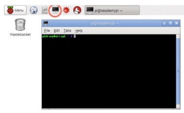

Click on the terminal icon at the top of the Raspberry Pi desktop (Figure 1) and enter the following command in the LXTerminal window (omit the "$" symbol; it's just a command line prompt):
sudo raspi-config

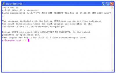

If you're using a computer running macOS or Linux, the programs required for connecting to Raspberry Pi are already pre-installed on your computer. Open a terminal session and enter the following command, replacing the Raspberry Pi board's IP address (192.168.1.23) with the address of your Raspberry Pi board:
ssh 192.168.1.23 -l pi
The first time you do this, you'll see the following message:
To proceed, confirm the authenticity of the computer you're connecting to by entering "yes." From this point on, all the commands you enter will be executed on Raspberry Pi, not on your computer.

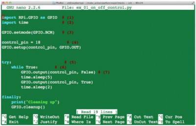

The screenshot shows the nano text editor in action.
Since nano is designed to work in a command-line environment (such as LXTerminal or via SSH), you'll need to navigate through the file using arrow keys instead of a mouse. When you're ready to save the file, press <Ctrl>+<X>, then press "Y," and finally, press "Enter" to confirm the save.
sudo raspi-config
The authenticity of host 1192.168.1.23 (192.168.1.23)' can't be established.
RSA key fingerprint is 48:8f:c3:07:c2:04:9e:8b:59:ed:53:2b:0b:d0:aa:e5.
Are you sure you want to continue connecting (yes/no)? yes
Warning: Permanently added *192.168.1.23' (RSA) to the list of known hosts.
p10192.168.1.23's password:To proceed, confirm the authenticity of the computer you're connecting to by entering "yes." From this point on, all the commands you enter will be executed on Raspberry Pi, not on your computer.
