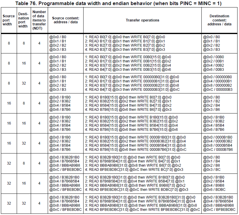

In the Reference manual for STM32F1xxx microcontrollers in the section about DMA there is such a table:
The table in the Reference manual may seem rather complicated (in fact it is). Let's understand it in one of the cases. For example, the data source is 32 bits and the receiver is 16 bits:
Suppose we transfer data from one array in memory to another via DMA. And these arrays have different bit sizes. The source array has 32 bits and contains the following data:
- element 0: B3B2B1B0, offset 0x00
- element 1: B7B6B5B4, offset 0x04
- element 2: BBBAB9B8, offset 0x08
- element 3: BFBEBEBDBC, offset 0x0C
As an array it will look like this:
uint32_t Sourse[4] =
0xB3B2B1B0,
0xB7B6B5B4,
0xBBBAB9B8,
0xBFBEBDBC
};Code: Select all
uint16_t Destination[4];for(int i=0; i<4; i++)
Destination = Sourse;
I think that people familiar with C will understand the result of this operation:
uint16_t Destination[4] =
0xB1B0,
0xB5B4,
0xB9B8,
0xBDBC

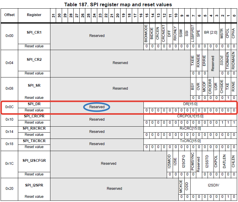

There is one very important and not obvious feature of the architecture of STM32 microcontrollers. CPU in STM32 is 32-bit, and for writing to memory 8, 16 or 32 bits there are different commands and different write requests. For RAM there is no problem: we can perform 8, 16 and 32-bit memory queries. But the AHB/APB peripherals can only be accessed with 32-bit requests. What if we need to write to a register that has a bit capacity less than 32 bits? Let me explain by the example of the same SPI. The DR data register has 16 bits, and the higher 16 bits of the 32-bit bus are simply not used:
If in the DMA we configure the peripheral bit size PSIZE = 16 bits and the memory bit size MSIZE = 16 bits, the DMA will duplicate the low 16 bits to the high 16 bits and make a 32 bit request to the peripheral:
0xABCD -> 0xABCDABCDCode: Select all

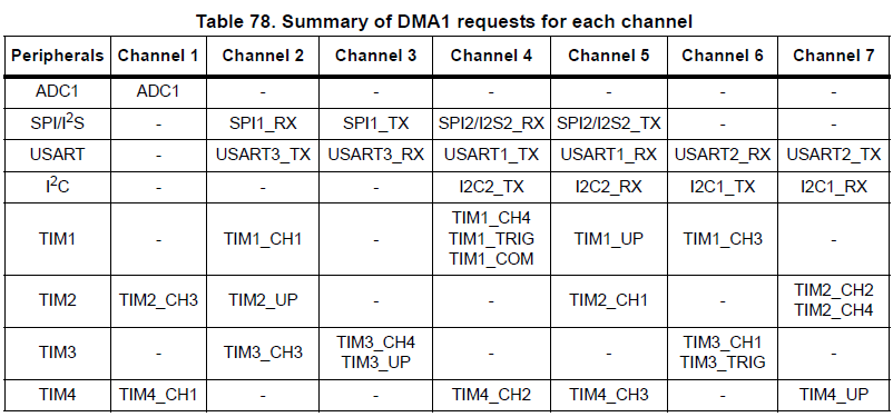

DMA1 in STM32F103C8 microcontrollers has 7 channels of data transfer, and each channel has its own periphery. Here is a table from the Reference manual to make it clearer:
For example, channel 1 can serve requests from ADC1, TIM2_CH3 and TIM4_CH1, and channel 2 from SPI1_RX, USART3_TX, TIM1_CH1, TIM2_UP and TIM3_CH3. It is worth noting that the requests themselves must be enabled in the peripheral registers, and if you enable DMA request from 2 sources, the data exchange will start from 2 different requests. I can't give you an example where this might be useful, and most likely this configuration doesn't make sense.
