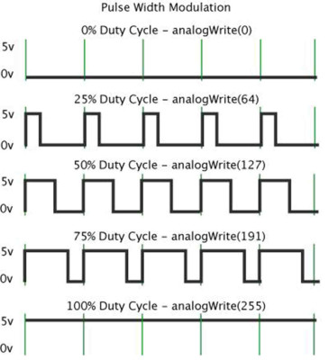

Arduino PWM
Pulse-width modulation (PWM) is a method of controlling voltage by varying the signal duration. PWM allows for smooth regulation of the load. An example is smoothly adjusting the brightness of an LED. This is achieved by changing the intervals between low signals, rather than the voltage. The principle of PWM operation is shown in the schematic: Applying PWM signal to an LED results in rapid flickering, invisible to the human eye due to the high frequency. However, video recording can capture these moments if the camera's frame rate does not match the PWM frequency.
Arduino includes a built-in pulse-width modulation (PWM) module. This is only possible on pins supported by the microcontroller. For example, Arduino Uno and Nano offer 6 PWM pins: D3, D5, D6, D9, D10, and D11. Options may vary on other boards, so it is recommended to refer to the specific board's description.
To use PWM in Arduino, the analogWrite() function is used. It takes the pin number and PWM value (from 0 to 255), where 0 represents 0% duty cycle with a high signal, and 255 represents 100%. Here is an example: the LED will smoothly fade in, wait for a second, then fade out smoothly, and so on. The example code is provided below:
// The LED is connected to pin 11
int ledPin = 11;
void setup() {
pinMode(ledPin, OUTPUT);
void loop() {
for (int i = 0; i < 255; i++) {
analogWrite(ledPin, i);
delay(5);
delay(1000);
for (int i = 255; i > 0; i--) {
delay(5);
